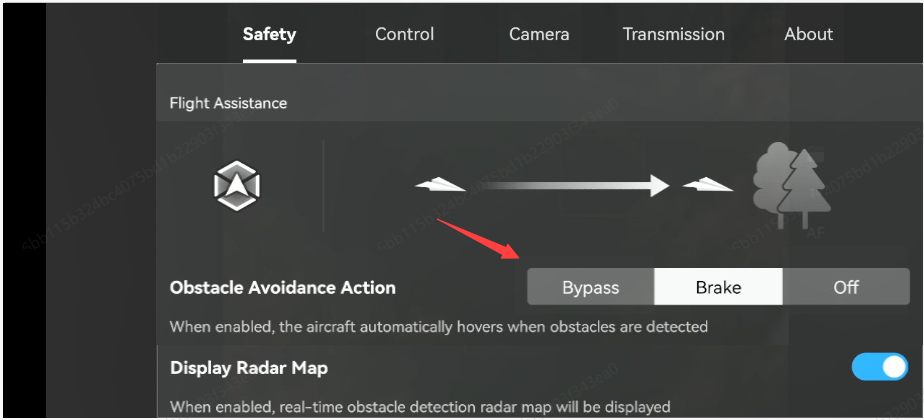

APAS is enabled by default, and the default Obstacle Avoidance Action is “Bypass”. You can select “Bypass” or “Brake” in the app.
Tap the “...” icon in the top right corner to select “Bypass” or “Brake”.
